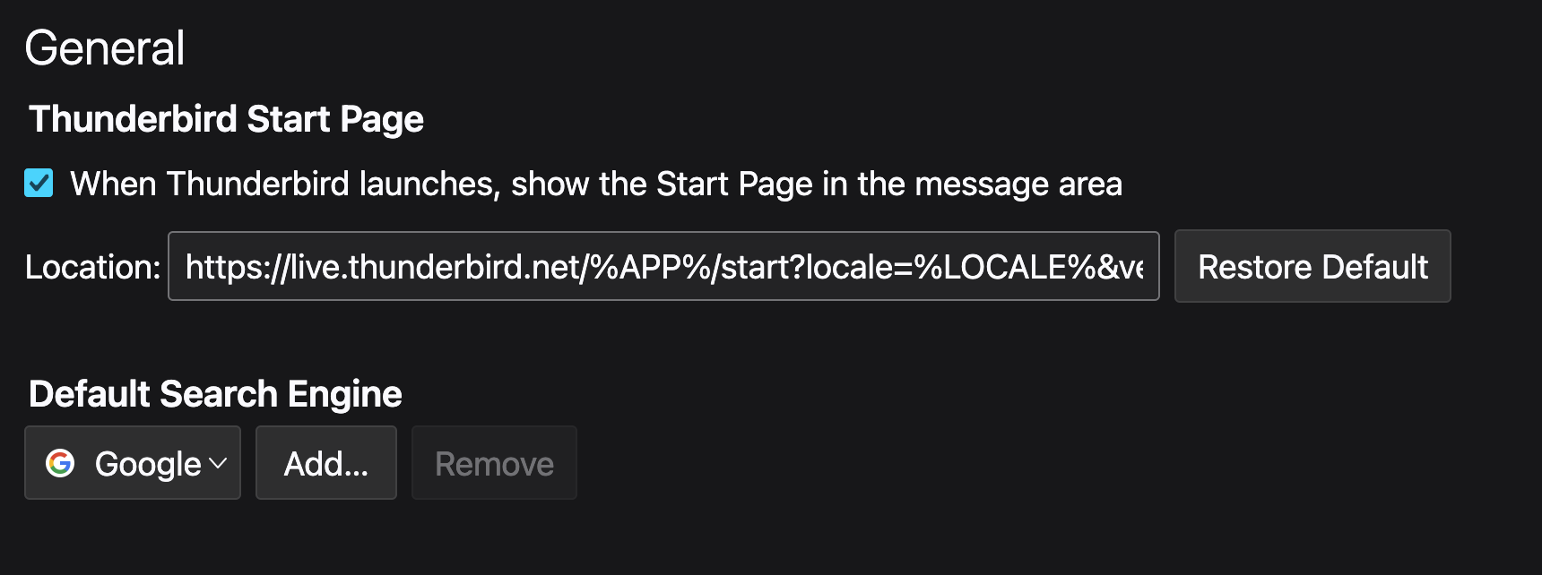

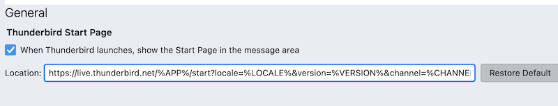

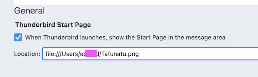

Go to Settings > General > Start Page, delete the "https://live.thunderbird.net/%APP%/start?locale=....." address and on next TB starts you'll see an empty start page. If you don't like a white start page you can customise it by adding the path to some landscape picture or some person's photo in the "Location" bar

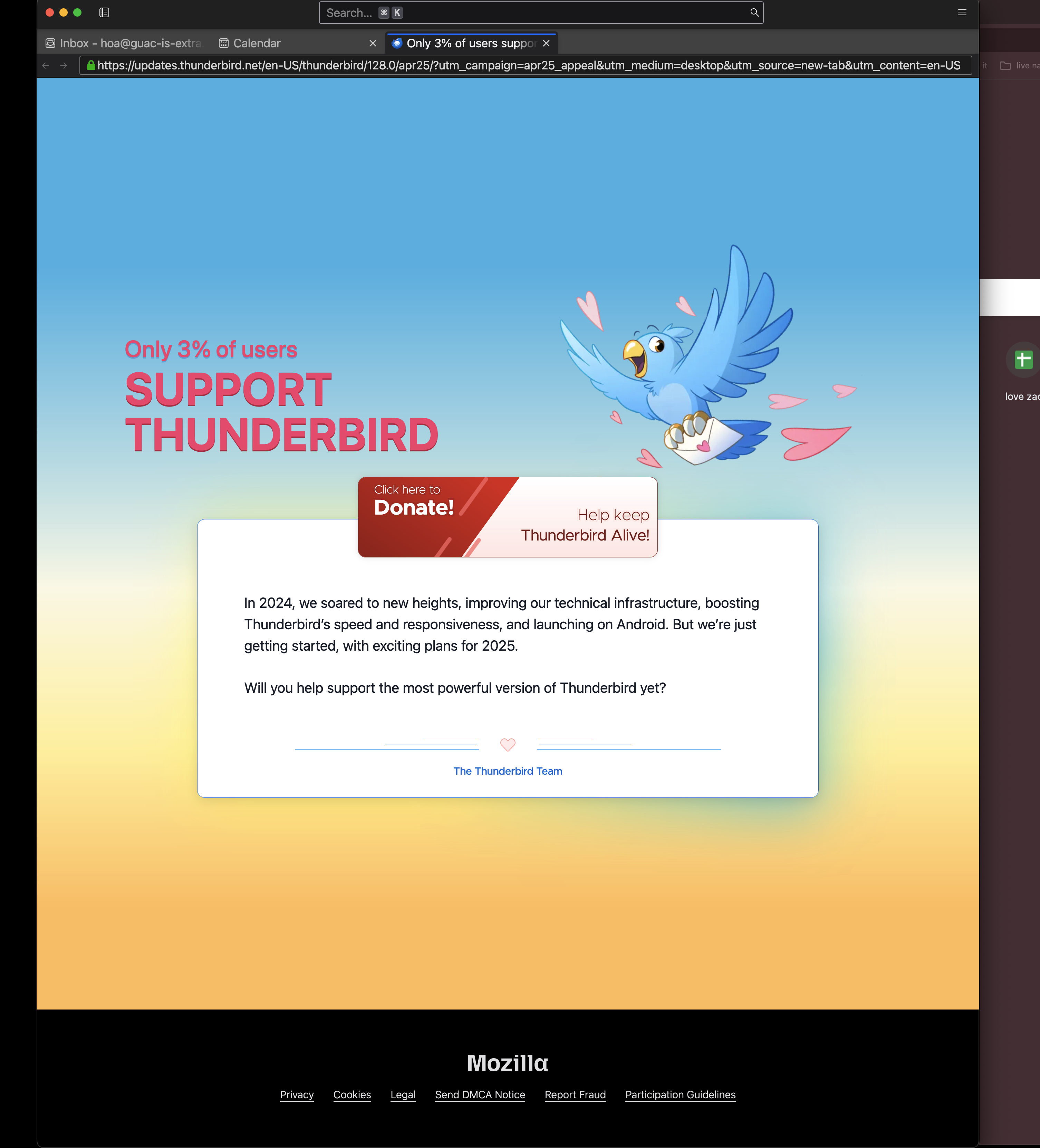

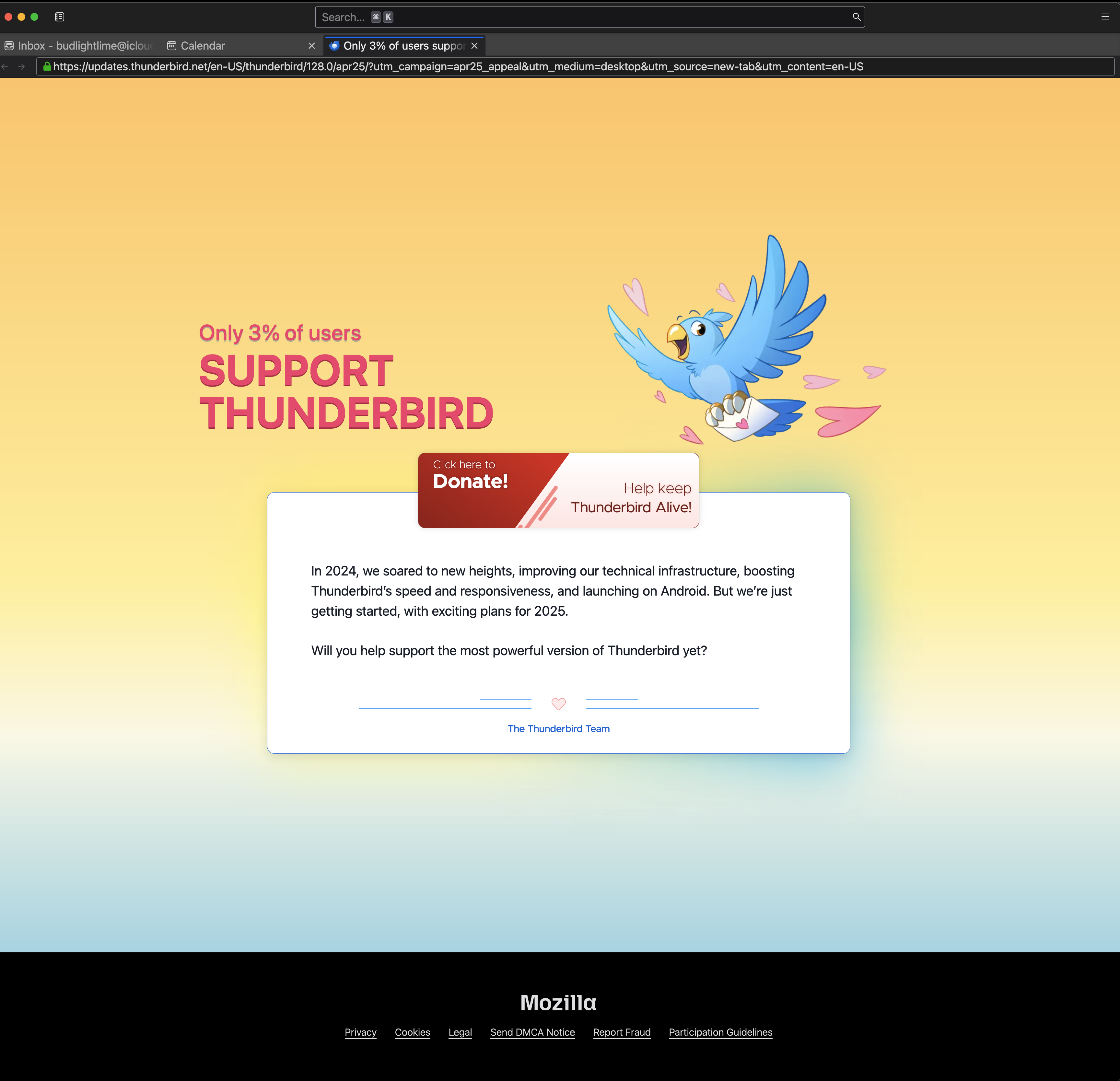

A new tab would pop up soliciting for donations which I'm all for, and I would have to close it.
What Mapenzi suggested worked, though. The tab no longer pops up which'll work.

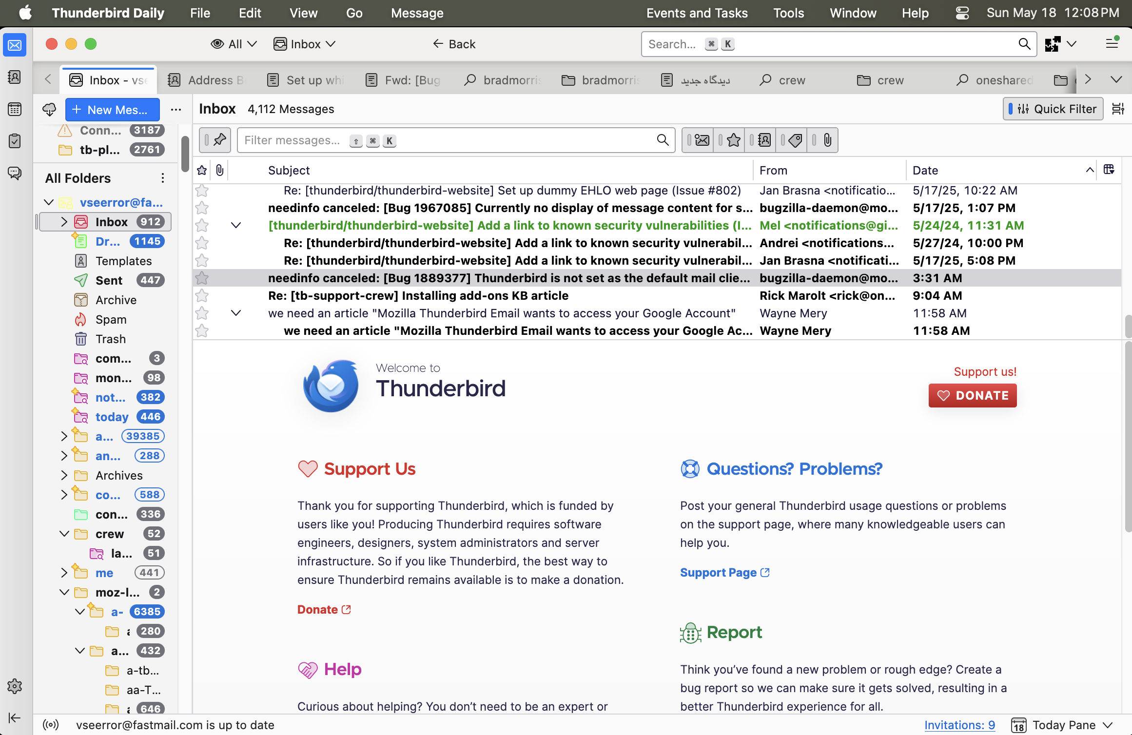

The start page does not show in a tab. It shows in the main viewing area, where messages normally display.
A new tab should only come up under two conditions: 1. If you got a notification asking you to donate 2. You clicked the donate link in the start page.
So, the start page should not cause a new tab or a donation pop up. But it sounds like it did. If it did, please tell us. A screen shot of the entire Thunderbird window would be even better, and much appreciated so we can solve the problem potentially for other users.

An example from my Mac, which correctly shows the start page.

Yeah, a new tab would appear altogether and I would have to close it.
Funny thing, I undid the fix that Mapenzi suggested, and it won't come up.

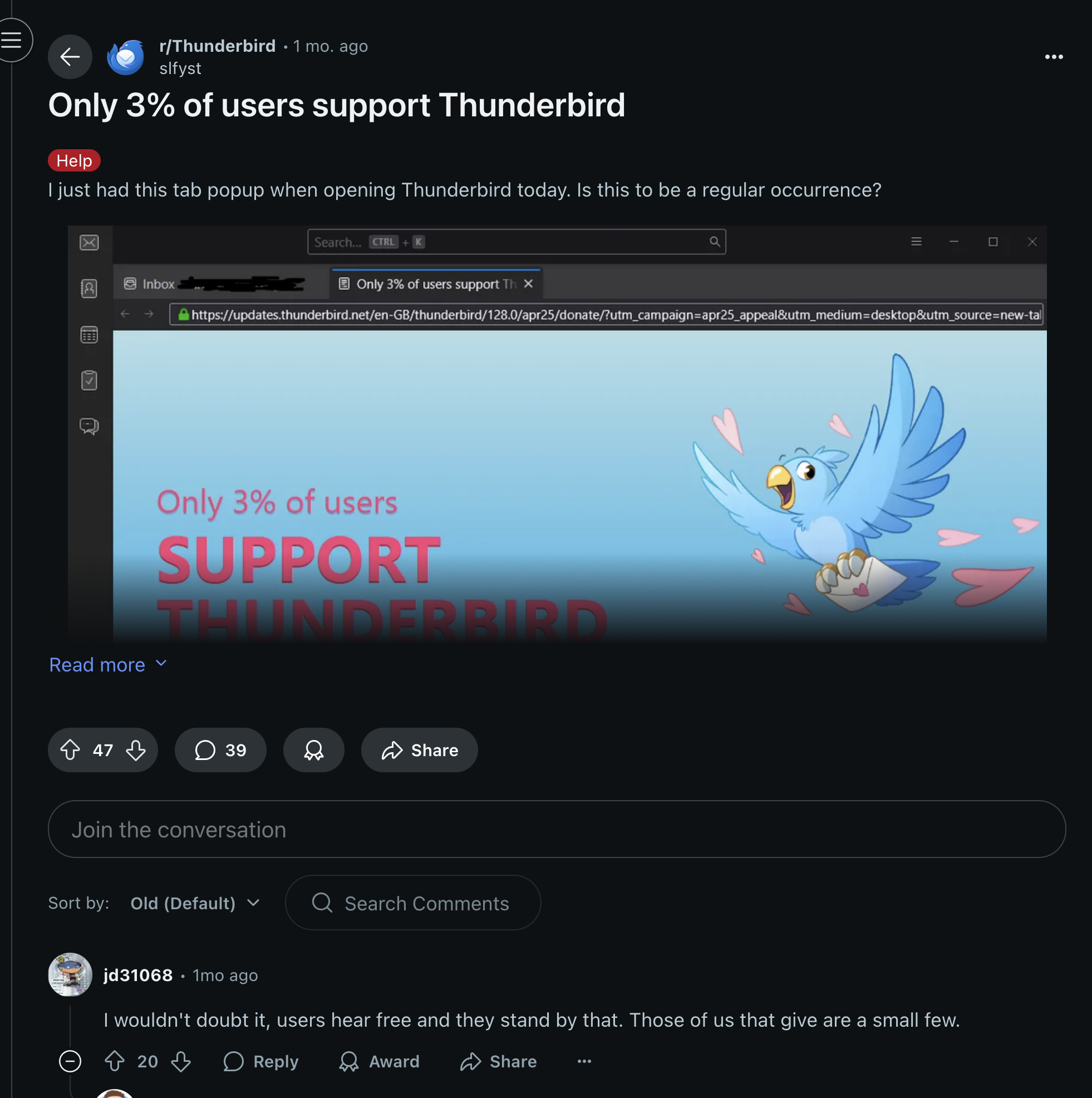

I did find someone on reddit who has the same issue.
https://www.reddit.com/r/Thunderbird/comments/1jr9g6j/only_3_of_users_support_thunderbird/

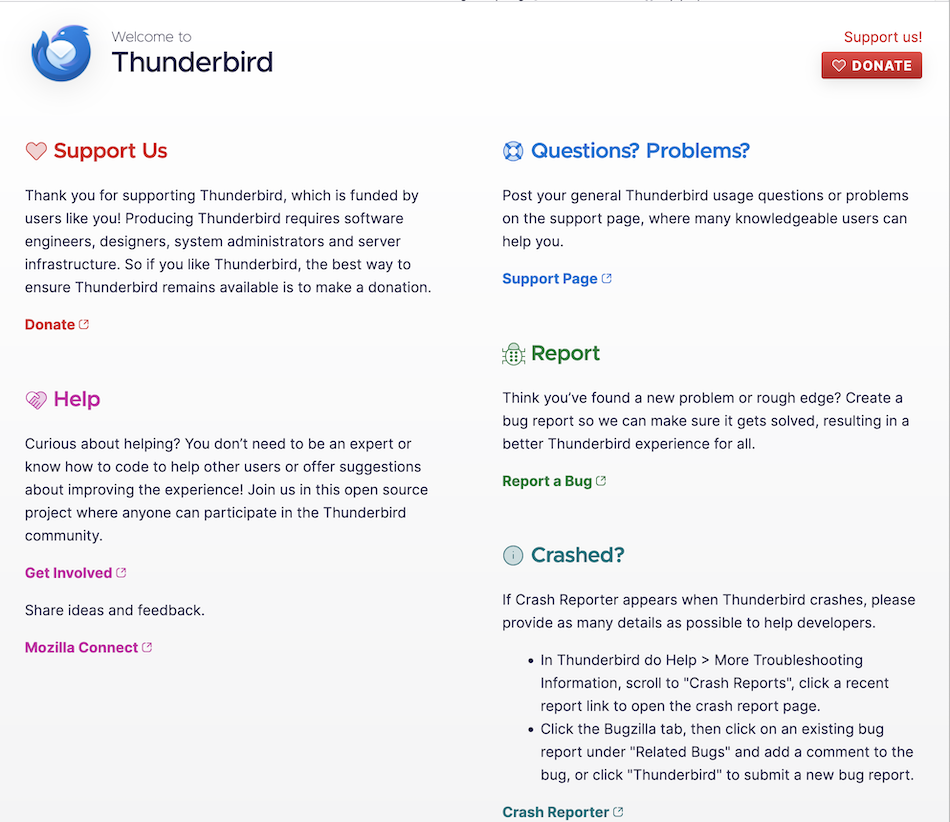

Gentlemen, this is (picture) what I see when I open TB 138 in my test profile of the en-US version. It seems to be the same picture as Wayne's. But I have noticed that many users in TB forums call this a "donation page" since it begins with "Support Us" and "Donate"

Anyhow I have an explanation: you received a "SUPPORT THUNDERBIRD" email and opened it in a new tab without closing the tab before you quit TB. Since TB proceeds to an automatic session restore on next start, this "support Thunderbird" tab would reappear each time unless you close the tab.

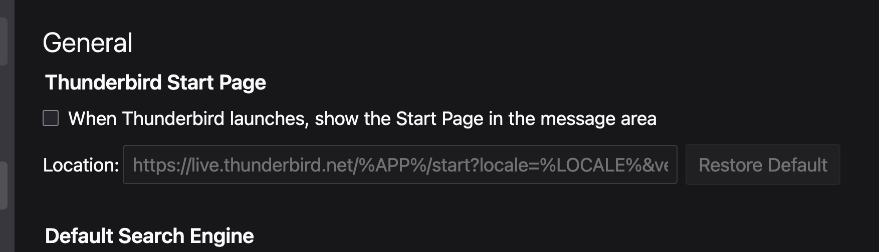

Ha, was able to make it pop up again.
Cadence:
  • power on macs
  • Thunderbird set to auto launch
  • after a minute or so the donation solicitation tab appears
  • show start page in settings was unchecked
Eh, whatareyougonnado.
